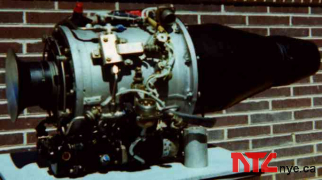

HJT-100 HJT-100
HJT-100
Wt.: 50lb
Dia.: 12"
Lgth.: 28"
Pwr: 150 lbt
Performance & Specifications
Maximum Rating at SLS Standard Day Conditions:
Thrust: 150lbt
Engine Speed: 75,000 rpm
Specific Fuel Consumption: 1.20 lb/hr/lb thrust
Airflow: 2.13 lb/sec
EGT: 1350 F
Cruise Rating:
Thrust: 107 lbt
Engine Speed: 68,800 rpm
Specific Fuel Consumption: 1.13 lb/hr/lb thrust

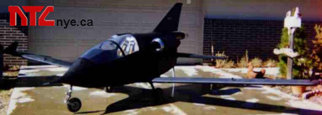

Bills BD
Bill's BD5 This is Bills BD5 powered by three HJT-100s  (top speed 250kts)

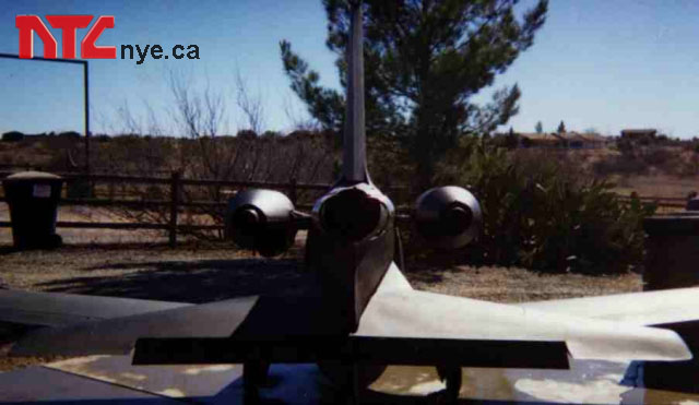

The reverser clams are visible The reverser clams are visible on the center engine in this view.

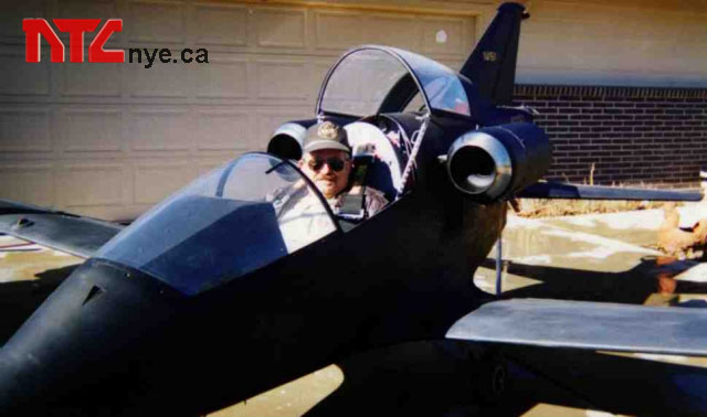

Bill getting ready Bill getting ready to freak-out the neighbors!

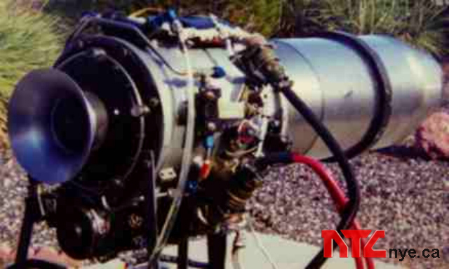

HJT-150 HJT-150 with After Burner
HJT-150
HJT-150 Specs:
Dia.: 12"
Lgth.: 36"
Pwr: 205 lbt
SFC with AB: 2.40 lb/hr/lb thrust.
