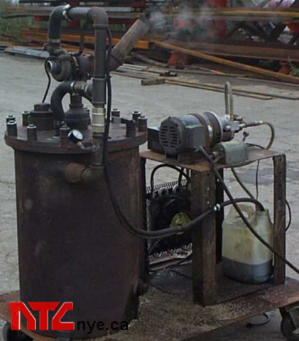

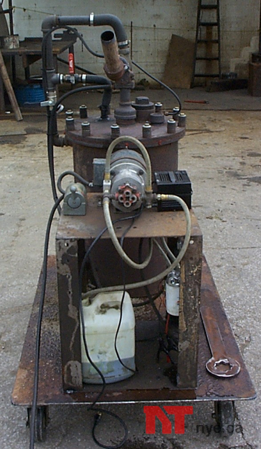

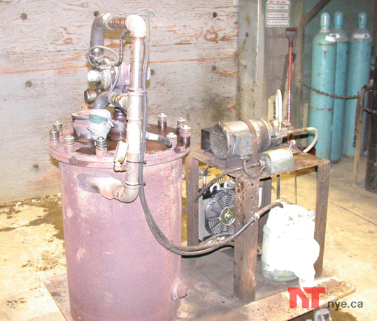

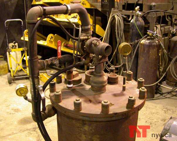

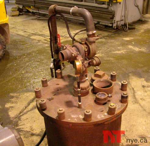

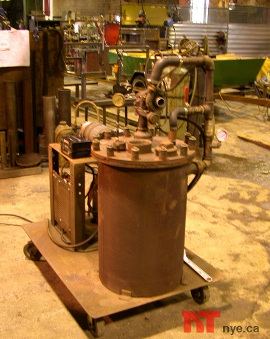

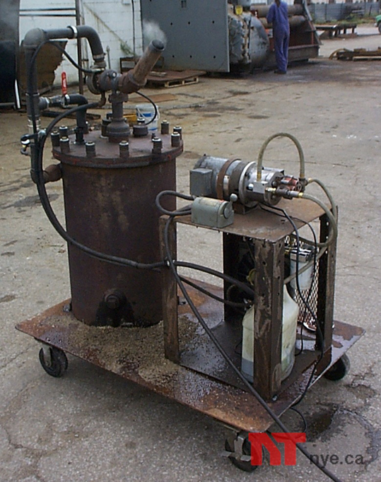

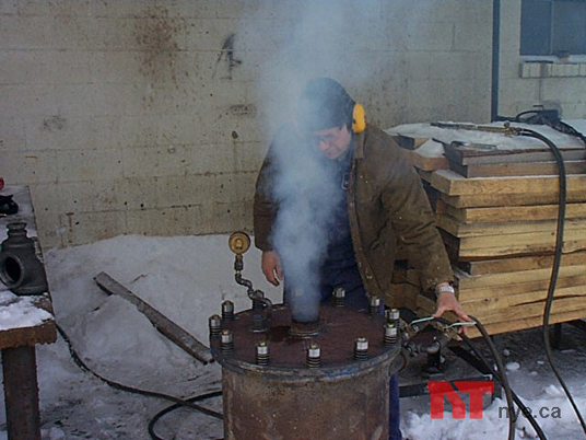

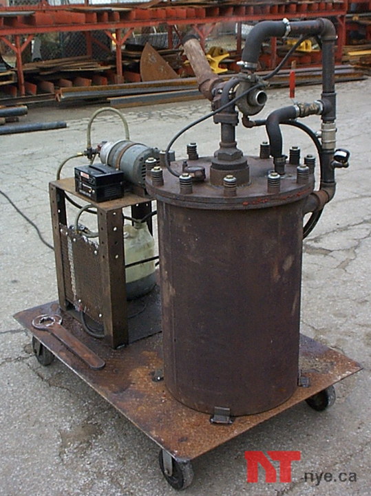

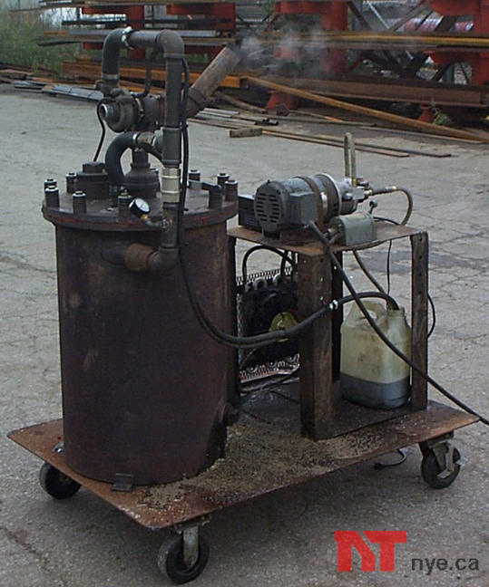

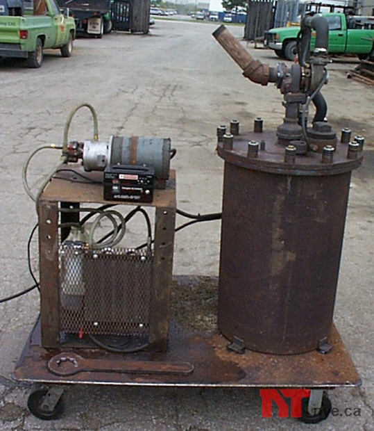

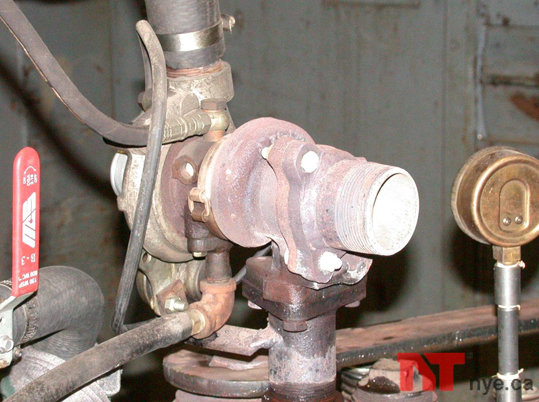

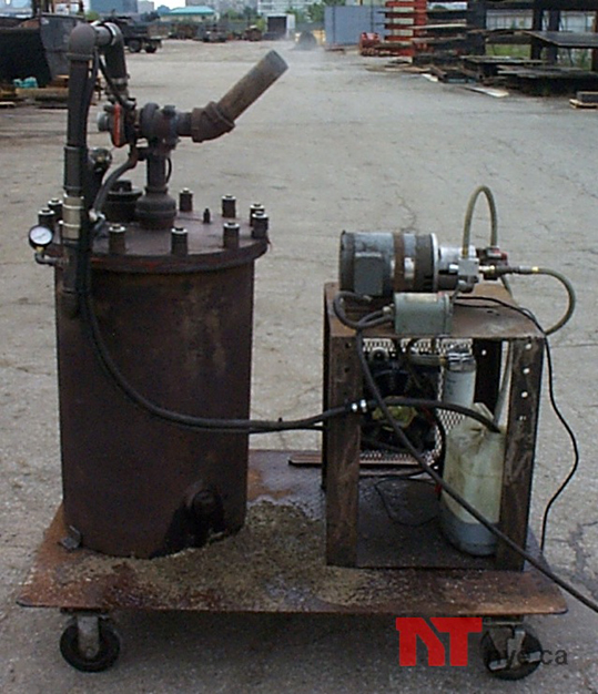

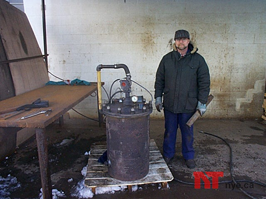

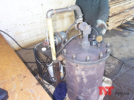

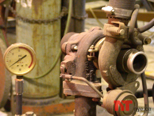

These photos were taken during the first ever trial run of the NT/6 gas producer section.

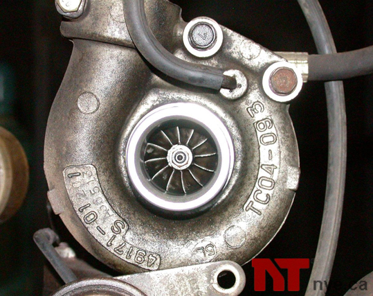

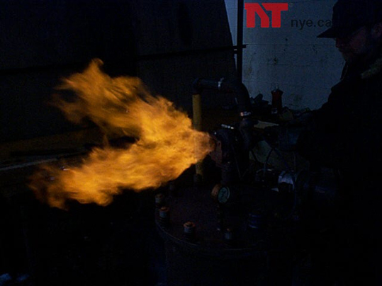

Fully loaded with 60lbs of split hardwood, 12PSI compressor discharge pressure. Approx. 120,000RPM gas producer turbine speed. 50PSI oil pressure. 1400deg F EGT. This thing really honks!

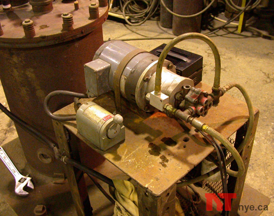

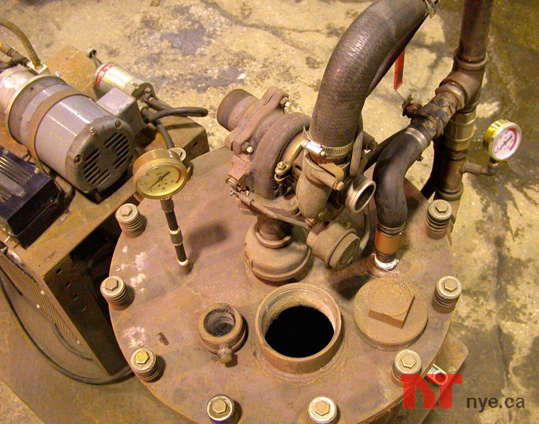

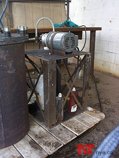

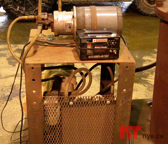

This is a good shot of the electric oil pump. The exhaust plume is visible on the left side of the turbo.

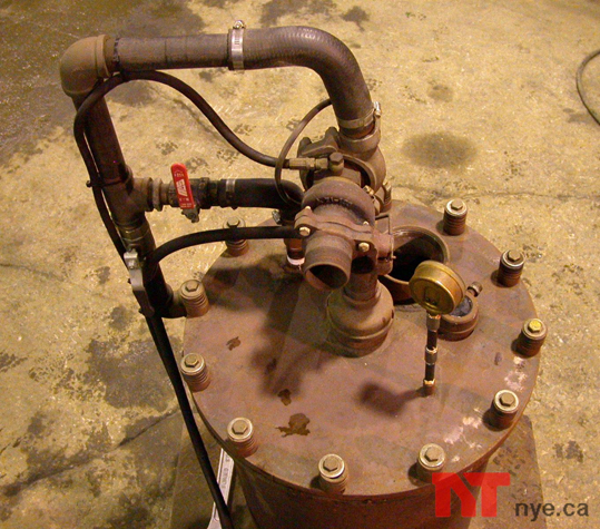

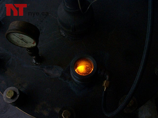

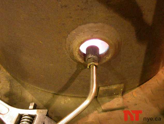

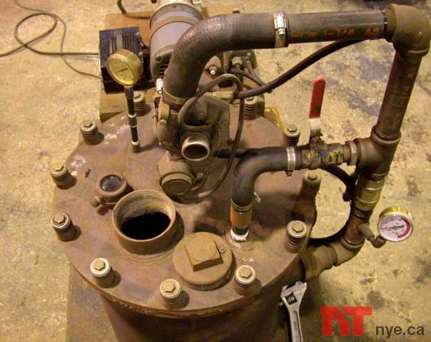

Here is a view of the fire in the combustor through the Pyrex sight glass.
The pipe fitting on the side is for air to keep the glass clean.

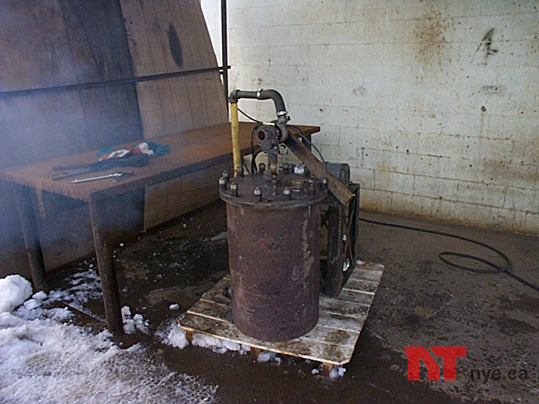

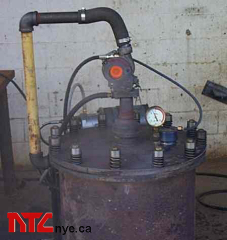

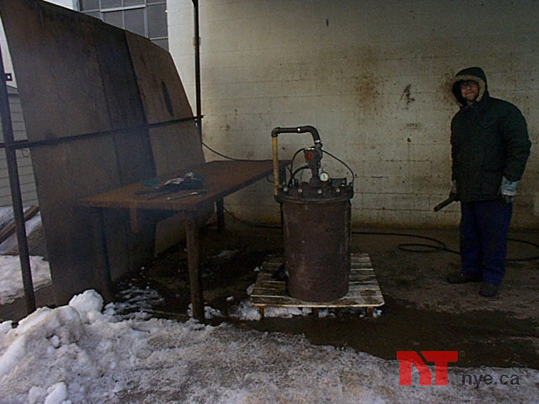

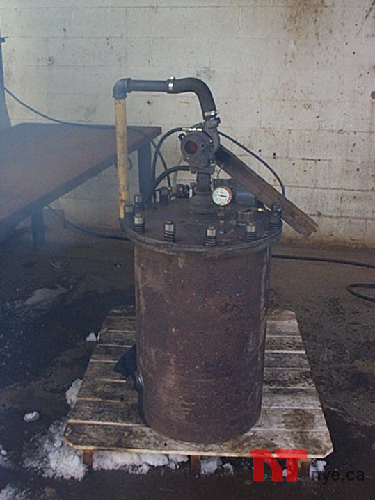

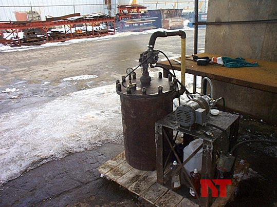

Update Aug. 21

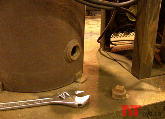

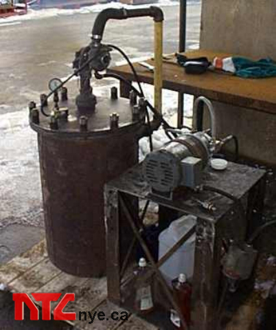

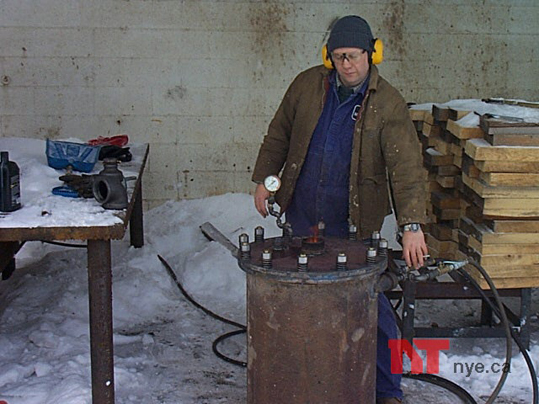

This is NT/6 after the first test of the throttle system. Throttling worked, but not exactly as expected. The needed changes were identified and will be made this week. Run time was :30 min @ 10-15 psi with no gas leakage as before. The sound is deafening, an air intake silencer is needed. The test was aborted at :30 min due to a blown compressor discharge air hose. The full load of wood appears to be only blackened.

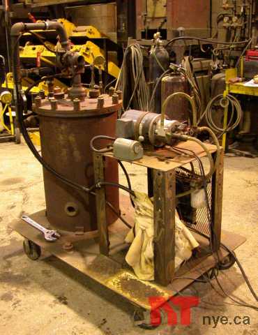

Update Jan. 20

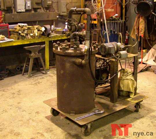

Finally I have had time to get back to this important project. The new throttle system works great! We have also learned to put less fuel in at start-up for a cleaner more controlled burn. This thing works even better than I thought. see the new videos below....
